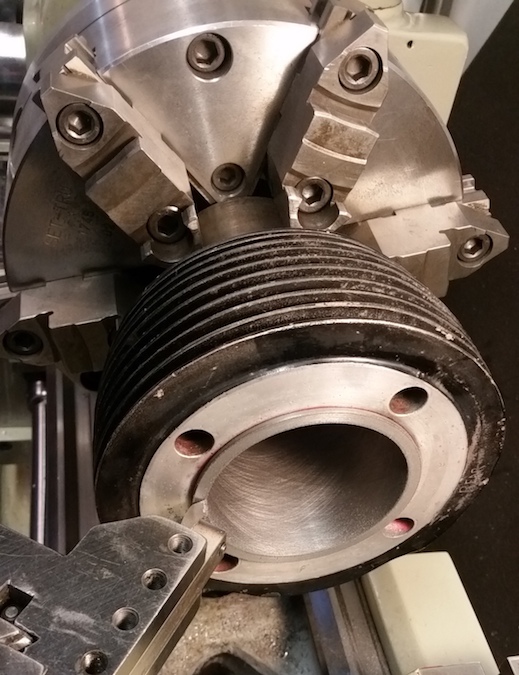

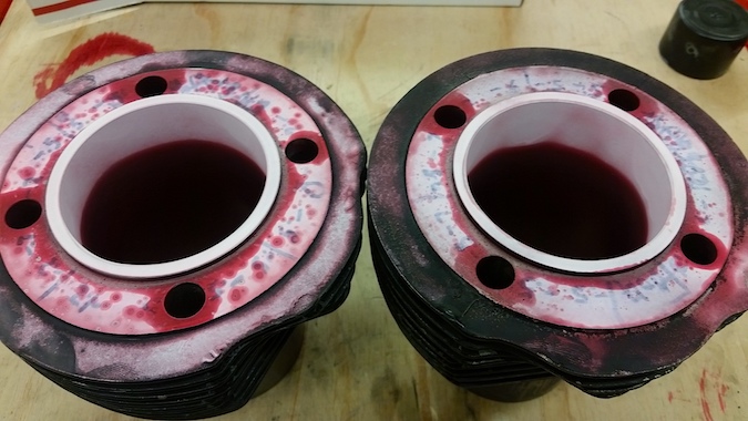

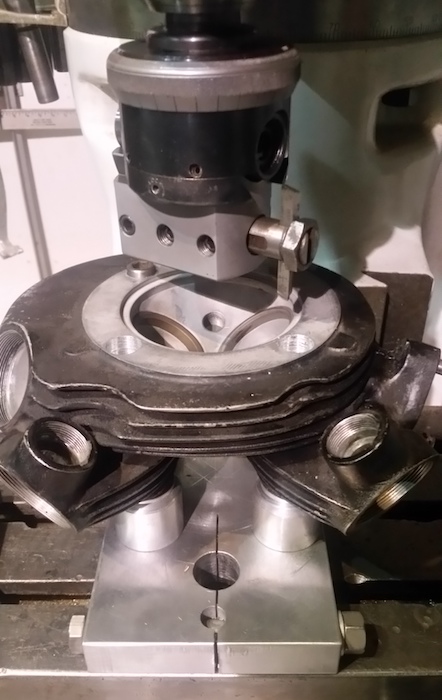

The cylinders are finished. The liners were magnafluxed at the top edge as this is where a crack would possibly develop.
This done, a .125" lip that stands proud of the muff (cylinder) on top is the sealing lip for the head as there in no head gasket. The second part is making sure there is a .003" gap between the larger surface on the head and muff.
This gap is critical. When the head is torqued correctly this gap will be zero and the head will not warp. I know, that's clear as mud.

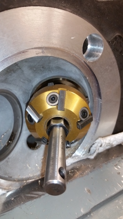

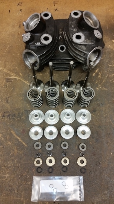

Heads are finished and installed.
The attachment 20190521_133807 copy.jpg is no longer available
Installing all the small parts is a bit tricky.
20190521_133807 copy.jpg (105.02 KiB) Viewed 58831 times

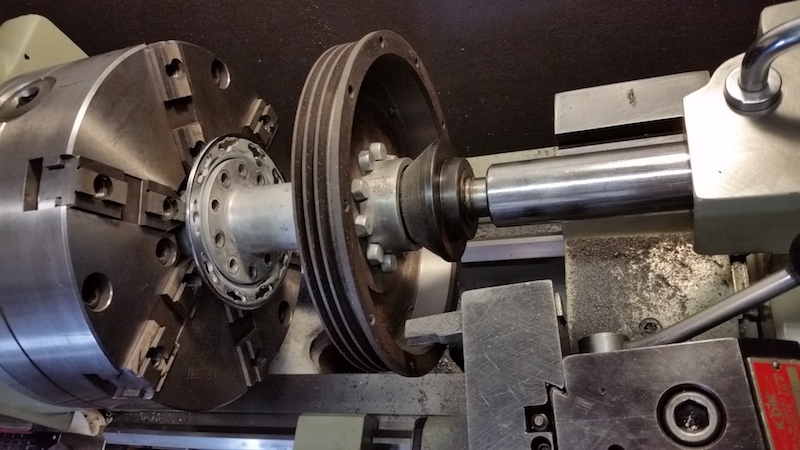

Been a while since I posted progress on the Vin. It's coming together slowly. As with any old bike the unknown sometimes out ways the known. The engine is buttoned up and most other parts have been massaged and ready for assembly.

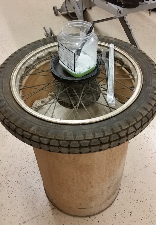

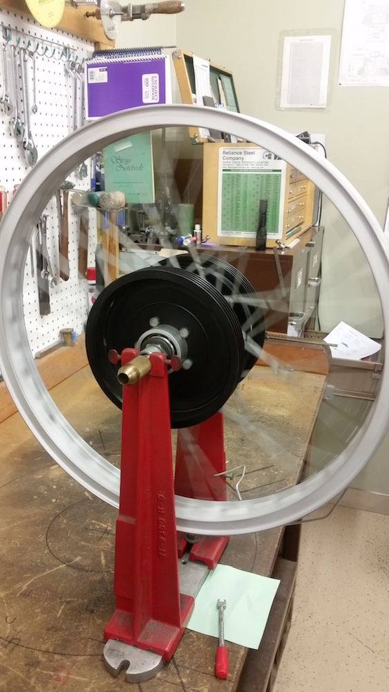

Wheels were stripped down, the drums turned and the tapered bearings re-packed. Then the both wheels had to be re-laced.
The special rear tire (tyre) arrived from the UK only to find the run out is so bad it can't be used. Will be discussing the problem with the supplier today.

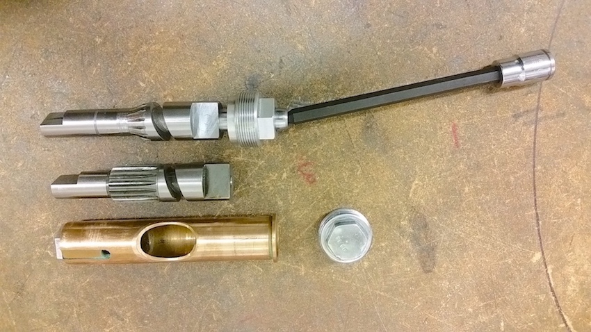

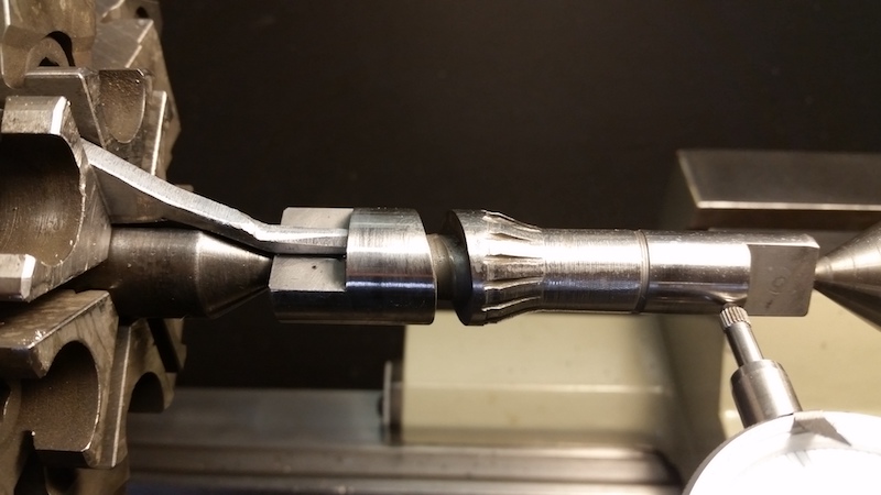

Priming a rebuilt Vinnie is a bit of an ordeal as there are several passages and restrictors before the oil is returned to the oil tank. It will be much easier doing it on the bench than in the frame and using the kickstart lever. This is standard procedure on many race engines so why not an old bike engine.
The gear teeth on the old pump piston is removed and a socket head adapter is attached at the end. This end inserts through a special oil pump retaining plug allowing for a ball end allen wrench to drive the pump with the drill motor. Since I broke my big toe yesterday trying to start a cranky old bike, this tool will be a life saver.
Oil pump primer2 copy.jpg (104.9 KiB) Viewed 58420 times
