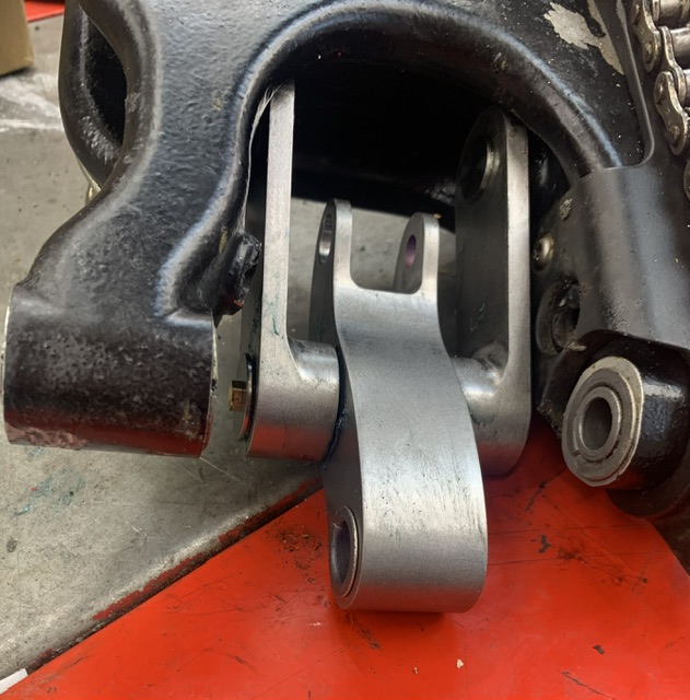

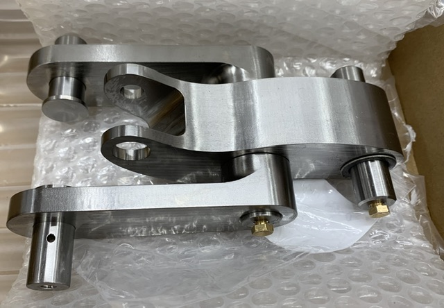

I bought one of these new in 2014, ride the heck out of it. I managed to break the rear suspension linkage twice- then I bought a Titanium one a Czech guy was making. Well, those are no longer made.
So I designed a setup in Fusion (3d CAD), 3D printed to verify I got it right, then sent files to an outfit that CNC the part from Titanium. I changed the middle pivot to needle bearings instead of original teflon coated bushings- there was not room to change the others without some major work. I also added lubrication passages/ports so no need to dismantle to lube. Since the teflon bushings have no seals, just pushing a bunch of grease through can also push out most of the water/mud etc.
This was a pretty fun project, I learned a bunch made some goofups and have something that should work darn well.

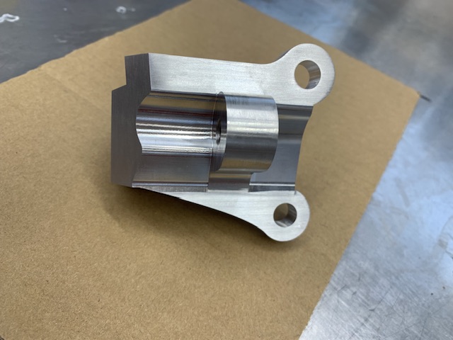

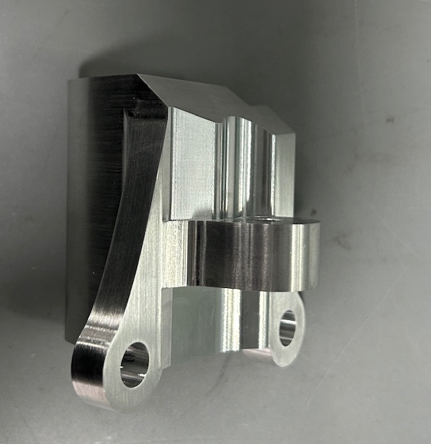

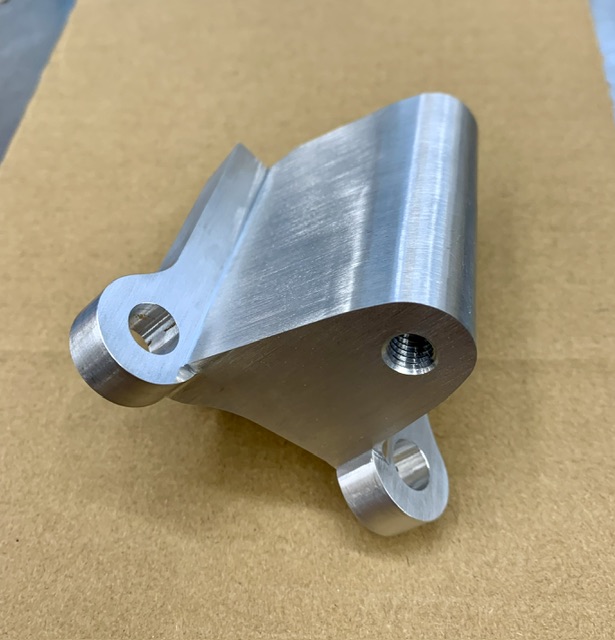

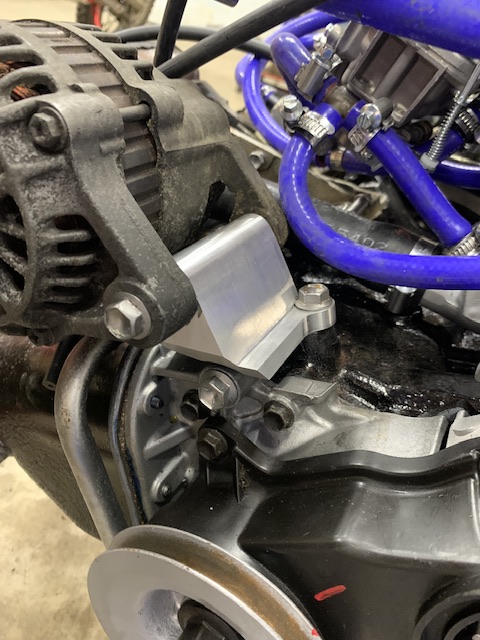

The Autozam Scrum (Japanese mini-truck) I’m rebuilding had a broken alternator mount. Only one place I found had replacements (used) and I won’t deal with that company again. Perhaps others had them, but I found I could have one much stouter made for less.
I desinged one, 3D printed to make sure I had it right and had the same outfit that did the OSSA linkage make it.
Came out great and $52.

Postby Lotus54 » Sat Jan 04, 2025 8:58 am
Original was pretty flimsy cast piece, with big cuttout in middle.
Here it is in place.

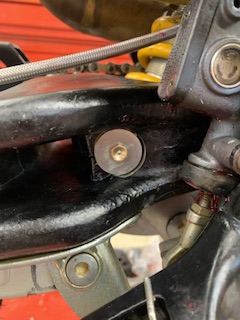

I did a small modification to the linkage, some type of dampers used are too wide in the spring seat area.
So this one adds more clearance.
the new one is all mounted up and works great. I like those flush grease fittings- the bottom linkage one can’t use a zerk type anyway since inadequate clearance.

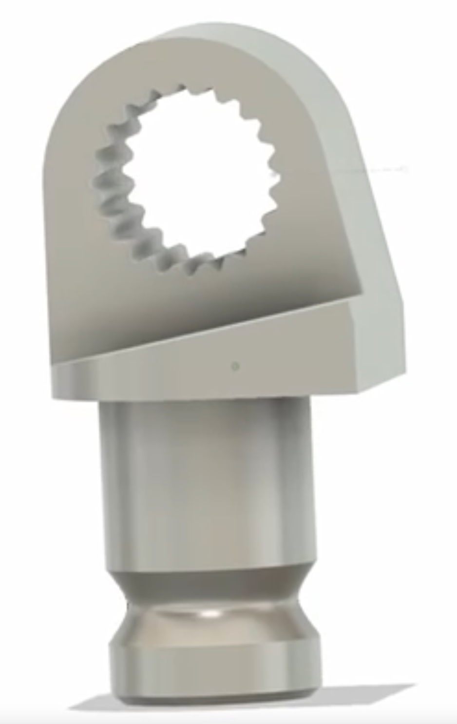

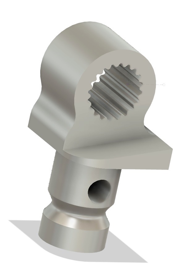

I’ve been working on a kickstart setup for a works Honda trials - RTL 250S. These are quite rare and many parts are not available.
Friend found a CR lever that should work and I modeled a new kickstart Knuckle that would work with it. I 3D printed and sent to him to test fit. If it works, I will send off and have it made from Steel or Titainium.

Postby Lotus54 » Thu Jan 23, 2025 8:37 pm
I have changed that design after looking at it again. I dropped the original ‘waisted’ area- I figured cheaper to machine and stronger too.
I did a movie of it, but does not appear to be a way to upload directly.
I also did more careful measuring- and then did ‘shaft’ part. I could test on original knuckle and get a better idea if I had it right. I did a couple more prints with new dimensions and will send off to owner to test fit.
Yes- doing something for the TY would be interesting.
