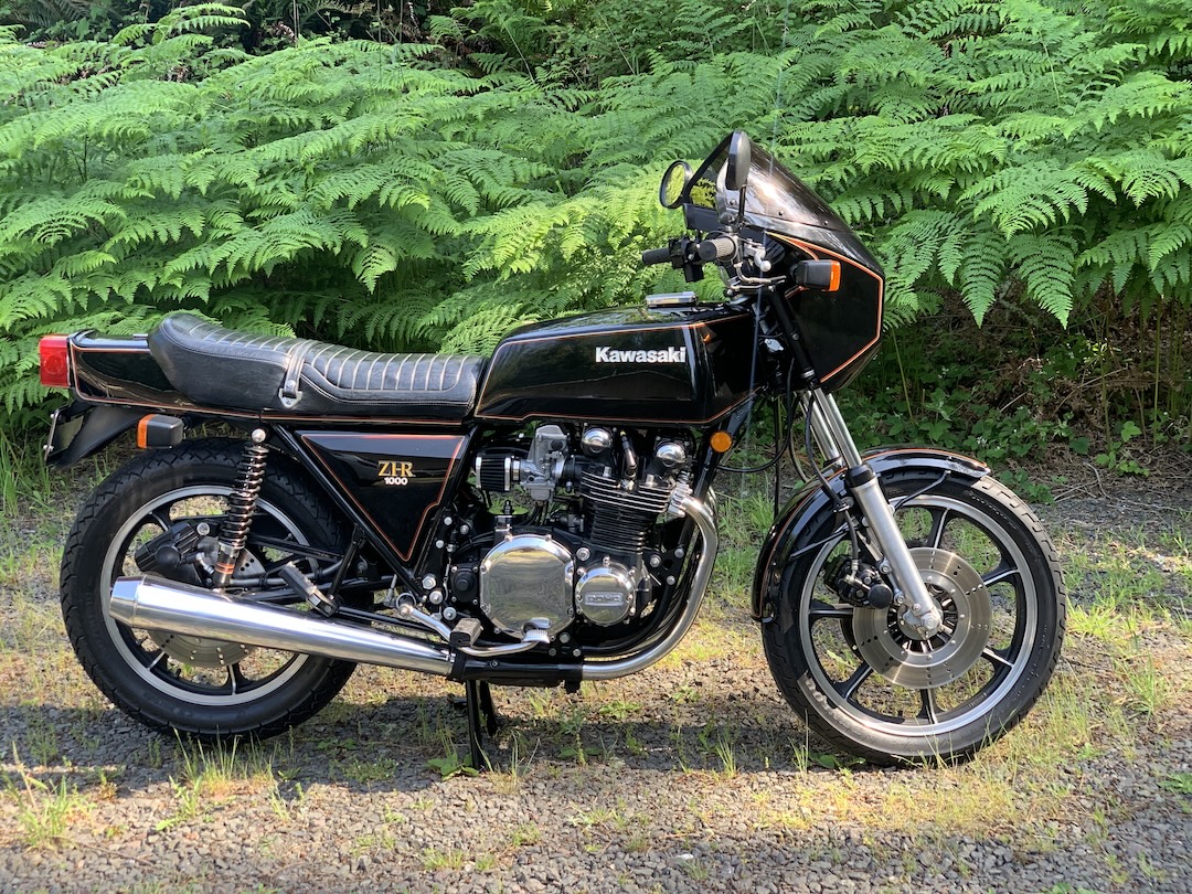

Postby John H » Fri Jun 06, 2025 9:15 pm
Well, this is a wrap. What started as a detailing job turned into a year long restoration. As it turns out, it's a 1978 motor and frame with all other parts being 1980. We're just going to call it a resto-mod.
Everything now is working good and overall a nice ride. I haven't been on a Kawi 1000 since 1986 so kinda brings back some memories..... On to the next project.
