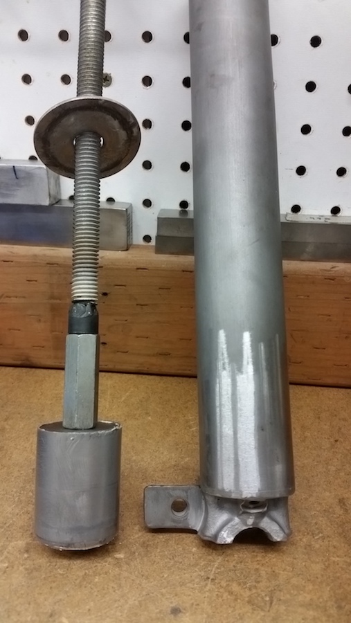

So you heated the dent from the outside, then pushed an appropriate sized rod through to push out the dent?

Yes, I heat the dent then drive the insert to that spot. The cylinder hone finishes the job.

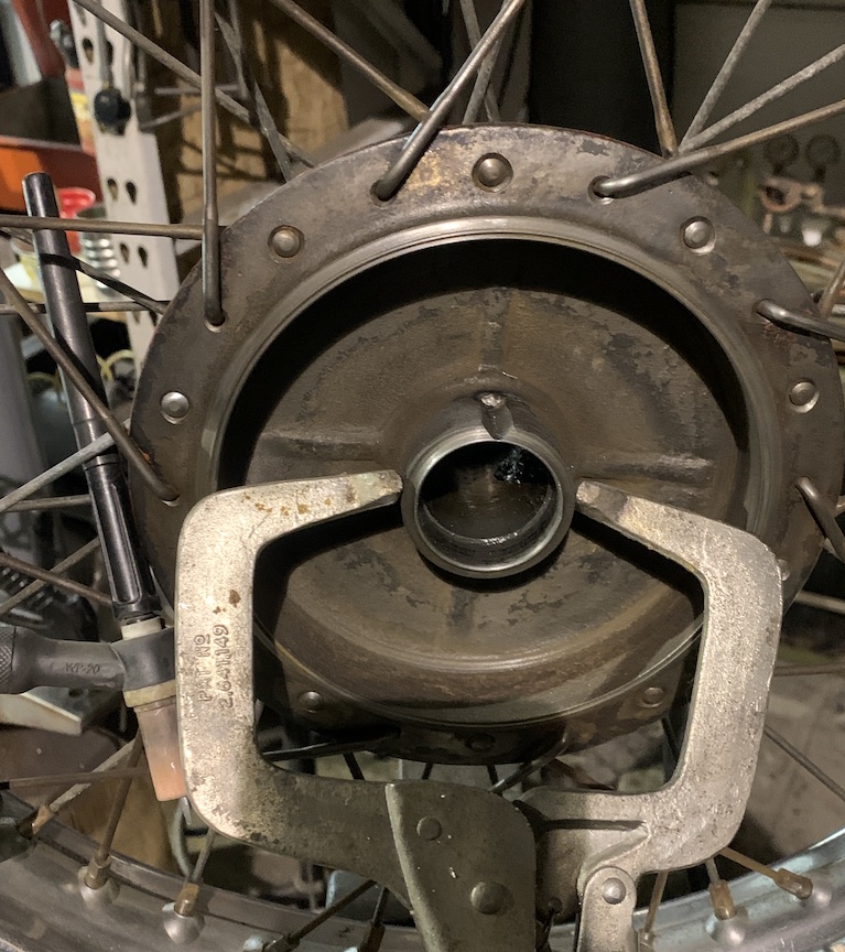

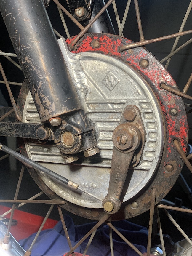

The wheel was another disaster. Still not sure what it's from but I don't think it's Triumph.
The brake baking plate is after market, I think.

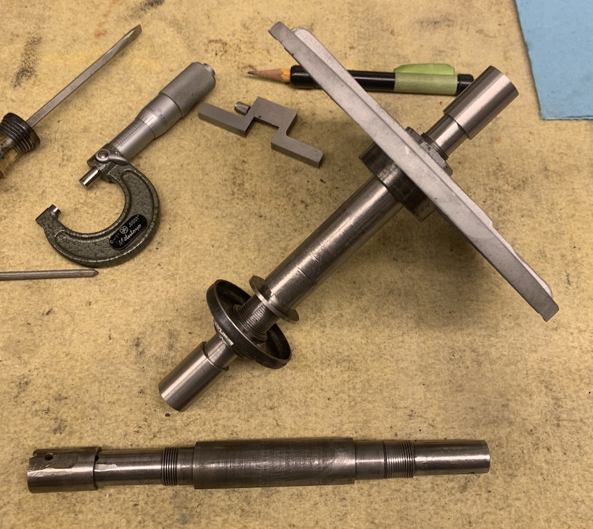

The axle was modified to fit the Triumph forks. It was badly done so a new one was made up and now everything fits as it should.
When fitting the bearings I found a crack in the hub so add that to the surprise. Anyway it welded up nice so next will be straightening the fender and brackets and mounting the number plate.

This is the insert I used to remove the dent in the fork tube. A good coating of anti-seize kept it from getting stuck in the bore.

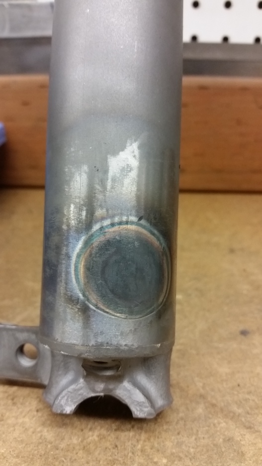

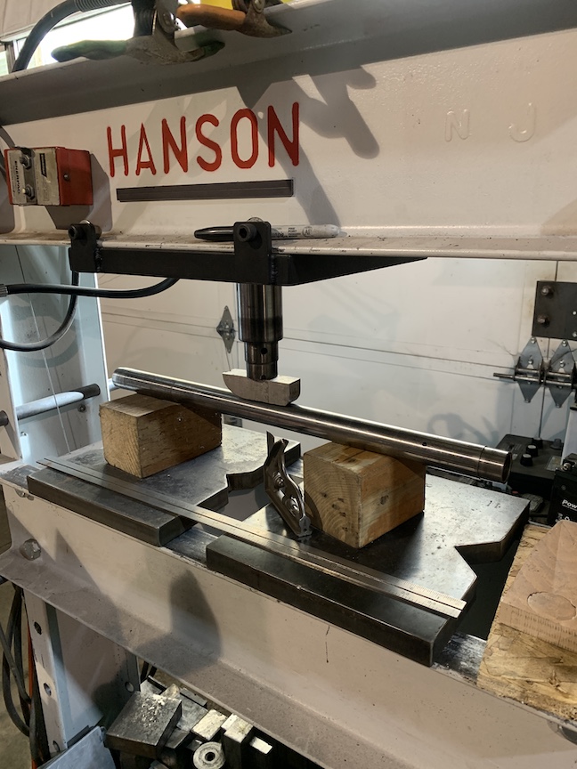

The forks are finally finished. The final step was straightening them. I got them within .003" and they slide nicely in the lower tubes.
Fork bent.JPG (201.75 KiB) Viewed 160836 times

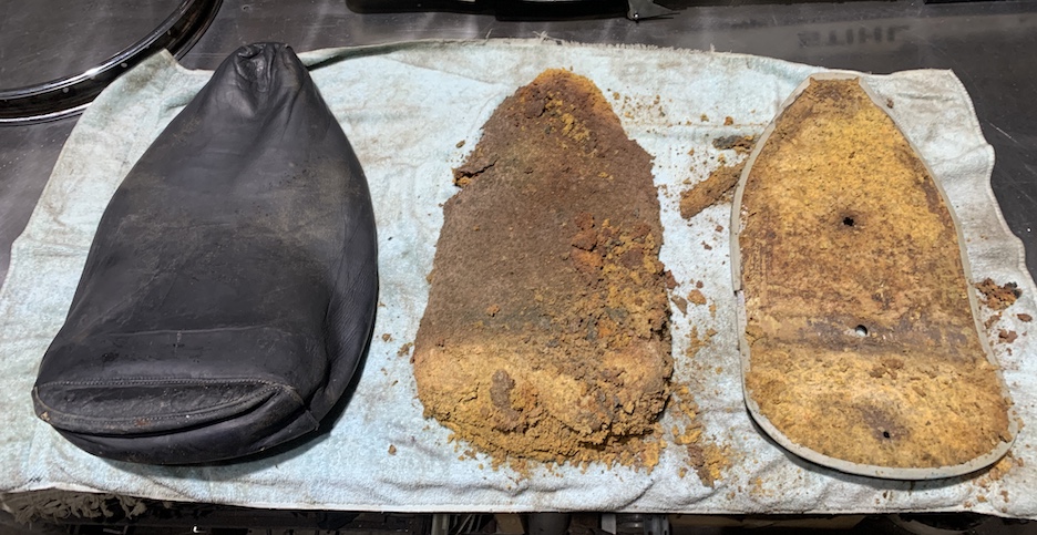

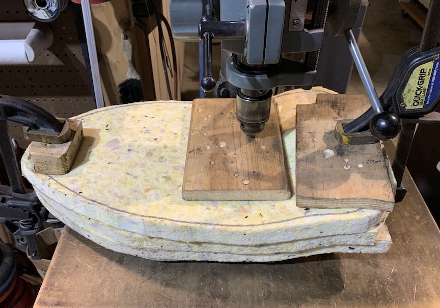

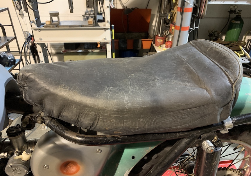

The leather on this old Bates seat was in great condition but the foam was totally gone.
The base is 1/8" steel and in good condition so I glued up three layers of foam and shaped it to what I thought was close.
Looks like it's ready for another hundred mile desert race.

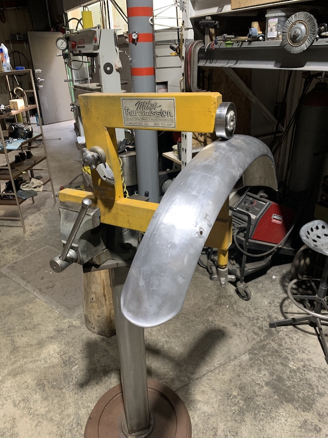

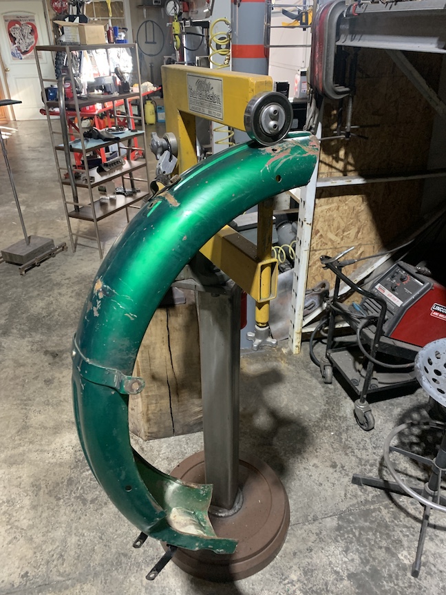

These fenders (mudguards) were in rough condition but I wanted to save them. It took some welding and hammering. I used the english wheel to smoothed the wrinkles just a bit.
