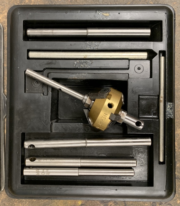

I have a Neway small engine seat cutter set for 30º and 45º available if it will help you out.
The range is from .625 to 1.00" The smallest pilot is .214".

Thanks John!
I just got a set of those (plus the intake is too large for that).

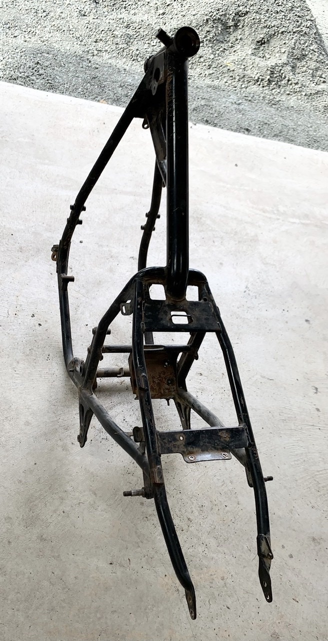

Frame ready to sandblast.

Will you sandblast your frame or send it out? I sent my Bonneville frame out for blasting and it was so coarse it had to be sanded down so as not to show in the finish. Won't do that again.

I’ll just sandblast it myself. Really only rusty around the battery box, but of course paint chips etc. I’m not looking for concours bike at all, but I am trying for very good looking but more importantly- great running/riding bike.
I was considering powercoat, but that is way too hard to repair when chips do happen, plus I can paint it myself. I’ve painted a number of frames, bikes and cars and think it will look good.

I got all the valves done. The Neway setup worked a treat.

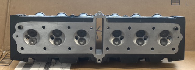

Next to match intake/exhaust manifolds up to head well. I’m not going to fool around with port work or any of that. I’m not looking for max performance. Just clean/match.
I’m not sure how long that will take (with other stuff I’m doing)- but after that is done and I do a really good clean on the head, then I can pop it on the engine, then cam, covers etc.

After ports are matched (getting close already, they are not bad at all) I will do a ‘super clean’ to get rid of shavings, valve paste etc. then install all the valves and pop on the head. That will be pretty cool.

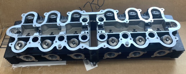

Postby Lotus54 » Tue Jun 08, 2021 6:53 am
Head together. Mounting soon
