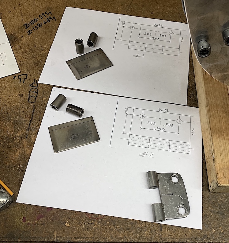

Postby John H » Tue Nov 23, 2021 8:13 pm

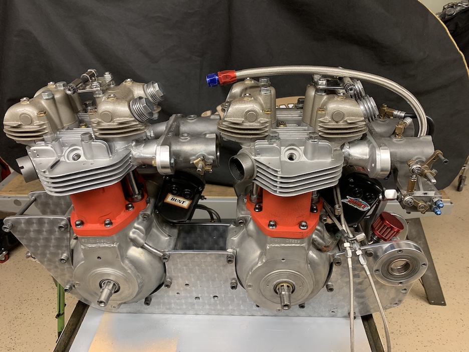

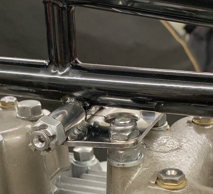

The 2 torque plates are different, in part due to wear and tear and probably different crankcases.
So each plate is fit individually. I didn't have any steel handy so made them from stainless steel.
The pieces need to be in place for welding so will move the unit out to the welding area tomorrow.

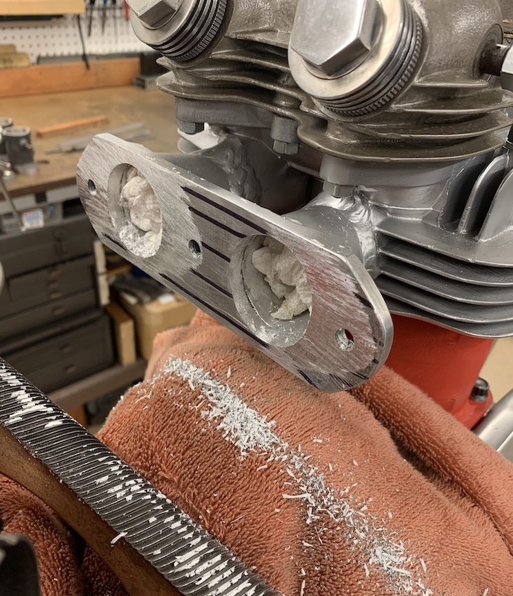

When mounting the injectors I noticed a seriously warped manifold. Now I remember there was an extra thick gasket here when I disassembled the motors. I had a choice of pulling the head and and milling the surface true or using a vixen file. Two hours later I had it filed flat.

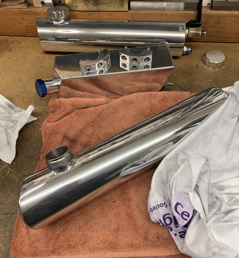

Double checked the oil and fuel tanks again before buffing them to the final finish. It's a dirty job for sure.
The fuel tanks will have Triumph logos on them.

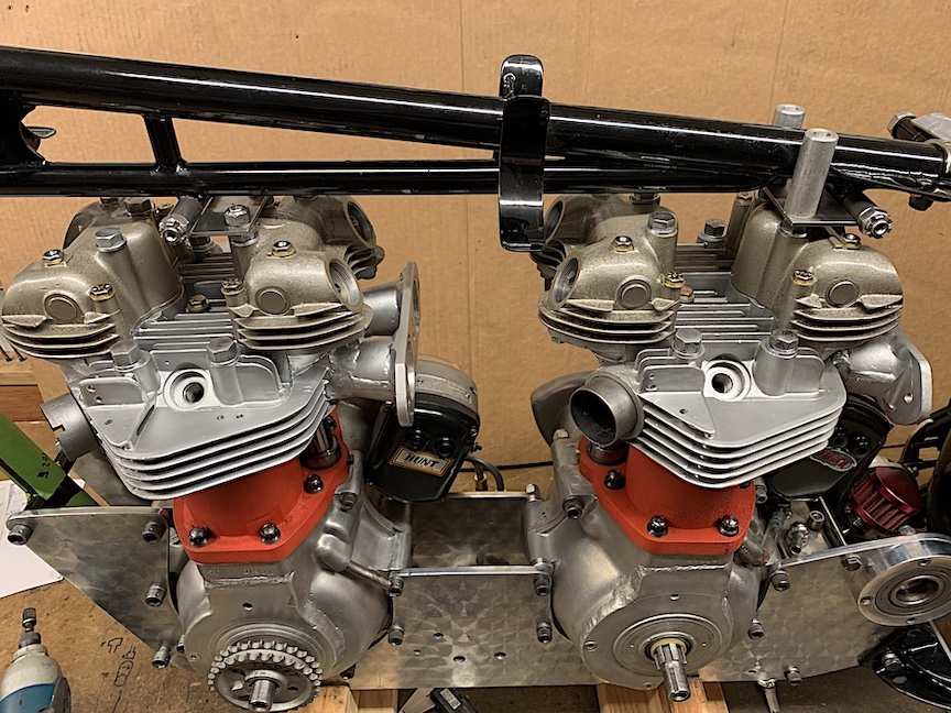

Postby John H » Thu Dec 09, 2021 10:17 am

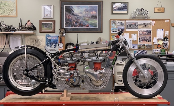

The Double, with the exception of the exhaust pipes, is finished. I haven't decided on chrome or ceramic for the finish.
On to the next project.
IMG_4958 copy.JPG (103.79 KiB) Viewed 74353 times
Re: Double Trouble
Postby Lotus54 » Thu Dec 09, 2021 10:34 am
Looks great!
Re: Double Trouble
Postby ClineDesign » Fri Dec 10, 2021 11:44 am
It looks great John, thanks for taking us all along on the road to recovery!
If you need a rest you can work on mine next.
Re: Double Trouble
Postby John H » Fri Dec 10, 2021 7:45 pm
Oh Yeh, I think it needs a supercharger on it. Merry Christmas
