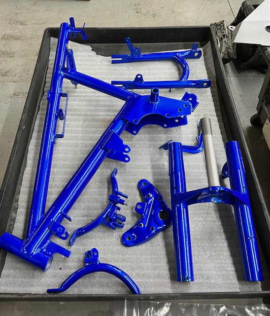

My plan was to paint the frame- but a person is buying the bike and I need to get it done very soon. So I took it to the powdercoater.
They did a great job. Fuel tank had some pinholes, so I Tig silcon bronze repaired them. A couple were a little tricky.
So tank is one done yet, but everything else is. I am reassembling now.

Looks nice. Who did the powder coating?
Re: Benelli Dynamo Compact
Postby Lotus54 » Sun Jan 14, 2024 5:12 pm
SDP - across 101 from State Partrol office (and bit East).
They did the wheels on my Lotus too- they came out so good I decieded to do the bike.
I was going to do the Wheels, but just had too many things to do and it was slow going getting old paint off.

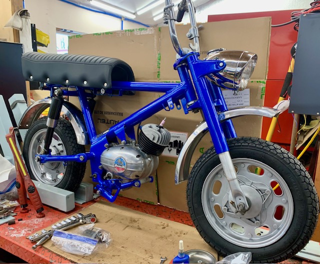

I made up a new wiring harness- just have to connect to the handlebar switch and do front brake switch.
Just waiting on a carb part I wanted to replace, and some pre-selector parts I decided to replace.

I was very happy with what he has done. All the appropriate places were blocked/masked, everything covered well. Also made good suggestions on colour and prep.
After the great job on the Lotus wheels, this was a good choice.

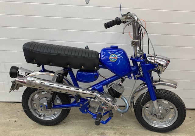

I fired it up today- first kick!
  I kicked it through with the stock Magneti Marelli plug to get things moving, but when I then checked it not very good spark. So when I really tried- I swapped with an NGK.
I installed the new handlebar light/horn/kill switch and ran it for a few minutes on my test fuel bottle. It seems to run pretty well. Tomorrow I will run it longer, test all the lights etc. waiting for a new fuel cap and a part for the pre-selector. Then I can fill tank and ride it around! That will be fun.
If all checks out I am done.
