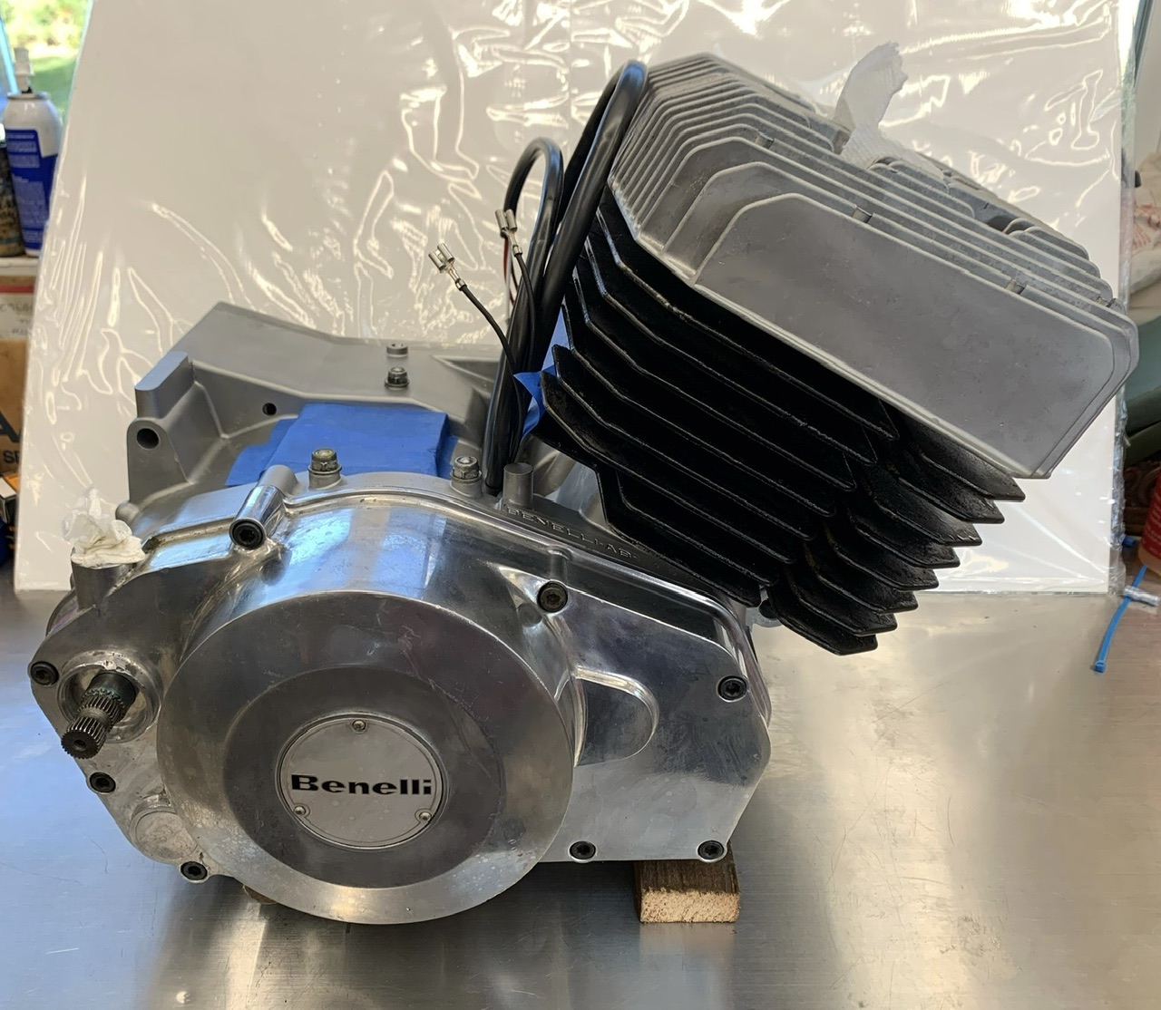

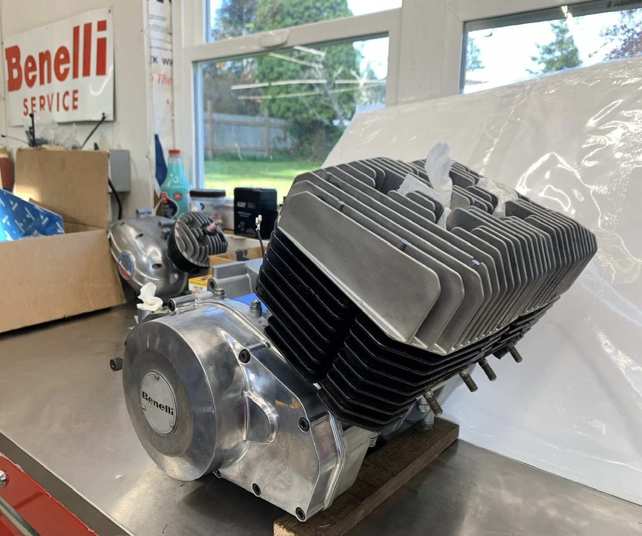

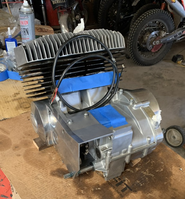

Postby Lotus54 » Thu Apr 27, 2023 5:43 pm
Ready to install

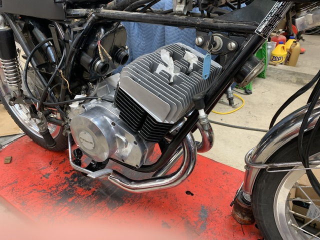

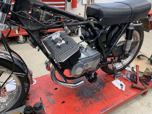

Postby Lotus54 » Mon May 01, 2023 6:50 pm
Engine is in. On to work on wiring for the mods and Vape system

Postby Lotus54 » Tue May 02, 2023 3:17 pm
I got the seal for the kickstart shaft I had forgotten to order. So took off the side cover, fit the seal, installed the gasket and mounted cover. Bolted the footpeg bracket back up.
Then thought I’d better see about the chain- I found a narrow ‘O’ ring chain I bought for something (not sure what) and it will fit fine I think.
Then decided to fit the new rear tyre. Found a small dent in the Borrani rim, not too bad but may consider doing something at a later date. Maybe new rim and stainless spokes. But not now. So tyre/tube/rim strip on.
Of course, I found the sprocket holder had been messed up by the chain at some point. So cleaned it up and popped on the lathe to smooth it out. Still a part I don’t like. Probably just smooth out some more- I am not sure welding on it is a good idea- although probably fine.
So everything always takes longer.
I still have not touched any of the wiring yet- once I get the rear wheel/chain on I think I will go ahead.
