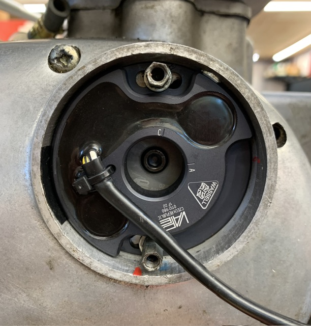

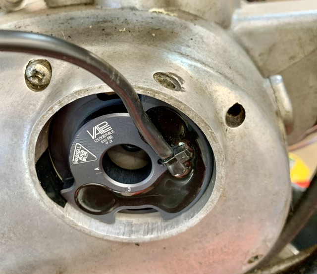

I was mounting the ignition- no issues with the magnetic rotor. But when I tried to install the stator- the only position I could mount it and still (barely) get the wires through meant I would have no adjustment at all. That means I better get it spot on or I have to remove and retime the rotor again (taper fit).
I’ve emailed seller for ideas. I could possibly open the slots a bit more-but do not want to do that unless instructed since it would certainly void the warranty.

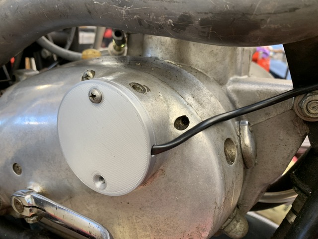

]To solve the issue of getting both the wires out and stator in middle of adjustment- I modeled and 3D printed a cover with side hole.
I do not know how well this particular material will hold up to engine heat- but I could use either high temp nylon if so- or just make it out of aluminium. I could make it or send the file off and have it CNC.
I need to go pick up some countersunk screws. I do not have many imperial screws/bolts/nuts.
[attachment=1]IMG_9778.jpeg[/attachment

I realized a made a bit of a mistake. I made a hole through the side- but that means I would have to have very small connectors so snake the cable back through if I need to replace or even take off completely the cover.
So I modified so a wide slot- allowing it to pop right off. I will just 3D print a flexible seal for that area and the original points wire hole.

After I made a 3D print of a cover that I liked- I did not have any hi-temp filament in silver, and could not find any easily. So I used the print as a model and made one on the lathe and mill.
Re: BSA B50 ‘Gold Star’ 500SS
Postby Lotus54 » Wed May 14, 2025 7:37 pm
Here is a picture- only one screw and no gaskets/plugs etc.
Doing wiring now.
