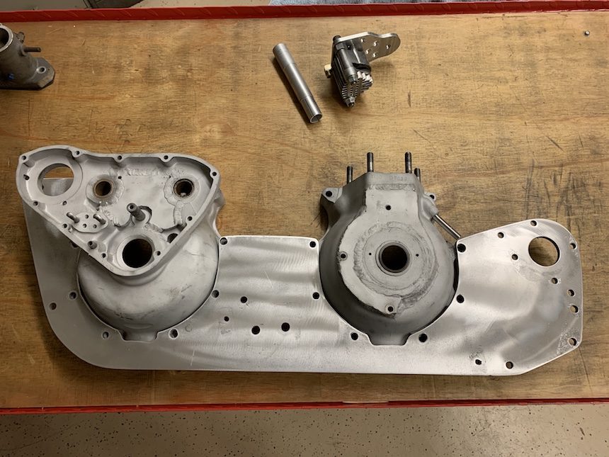

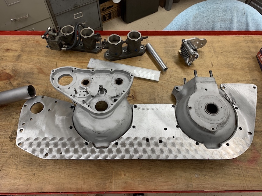

A bit of bling will dress up the engine plates and hide a lot of blemishes. I did a bit of testing on the backside to get a pattern
going. The swirl is larger than I'd like but it's what I have so what do you think?

Postby Lotus54 » Fri Mar 27, 2020 11:10 am
I like it.
Re: Double Trouble
Postby ClineDesign » Fri Mar 27, 2020 3:53 pm
Looking great!
Re: Double Trouble
Postby ATinkerer » Fri Mar 27, 2020 4:12 pm
Definite progress being made.

Thanks guys. I want to see more of you guys share your projects. They're more interesting than you may think.

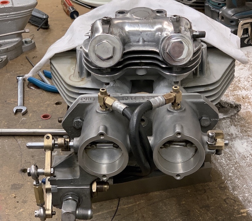

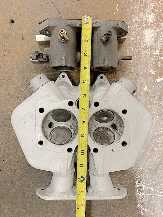

The rear head has fins removed between the exhaust pipes to give the front engine throttle bodies for free air. The crankshafts are only 13-1/2" center to center. Not an ideal situation but Nitro doesn't rely on atmosphere like methanol or gas.

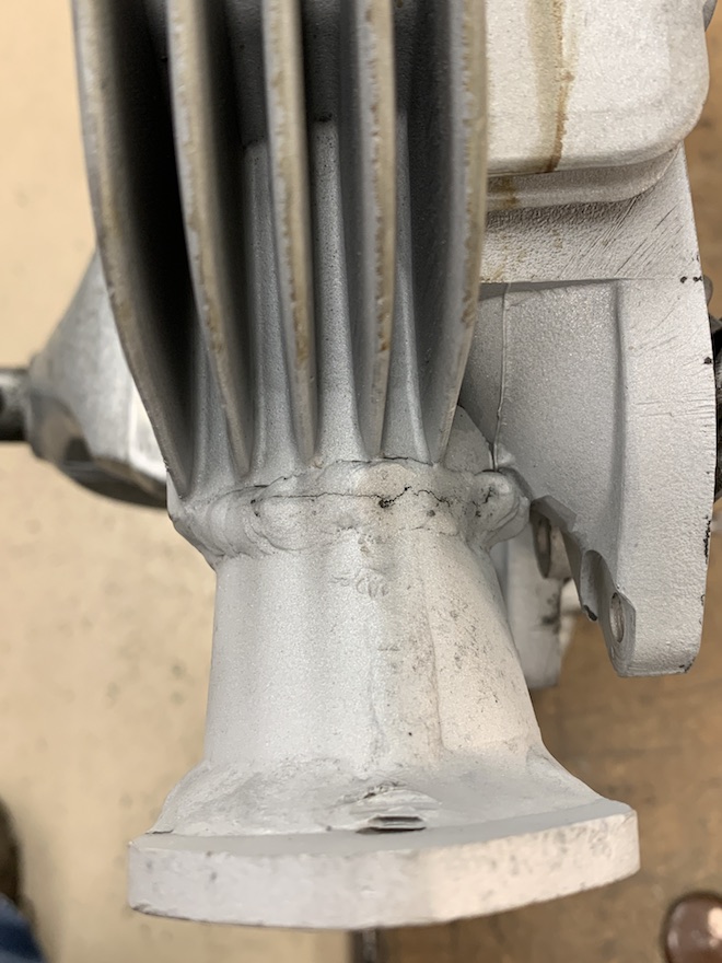

Further inspection shows a crack where the manifold is welded to the head. This could have happened when the engine blew. More surprises every day.

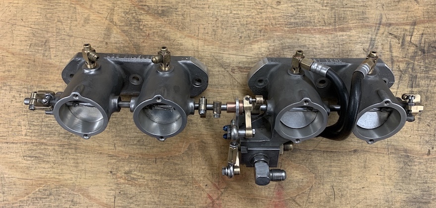

The story on the injectors is they were made for a Offenhauser midget race car which was about 100ci. The two Triumph engines equal about 100ci also.

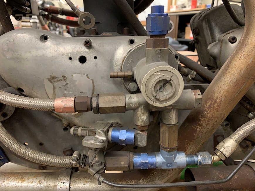

Next step will be disassembling the Hilborn 150 fuel pump. Hopefully it's rebuildable.
