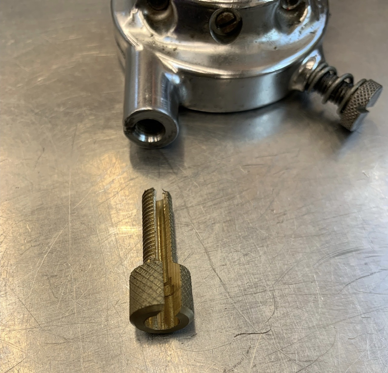

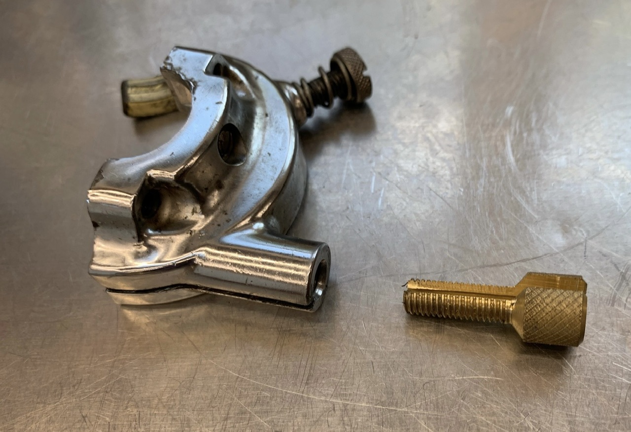

The throttle cable adjuster had broken. I’m going to replace the throttle and splitter with a two-cable setup, but in the meantime, I made a new adjuster. The knurling is not very good- but it is functional
Re: Benelli 250 2C
Postby John H » Fri May 19, 2023 7:25 am
Knurling takes some practice to get a perfect pattern. What brand is the throttle?
Re: Benelli 250 2C
Postby Lotus54 » Fri May 19, 2023 8:30 pm
Tomeselli.
I’ve done a lot better knurls before, but this was a different tool, different lathe and different material.
