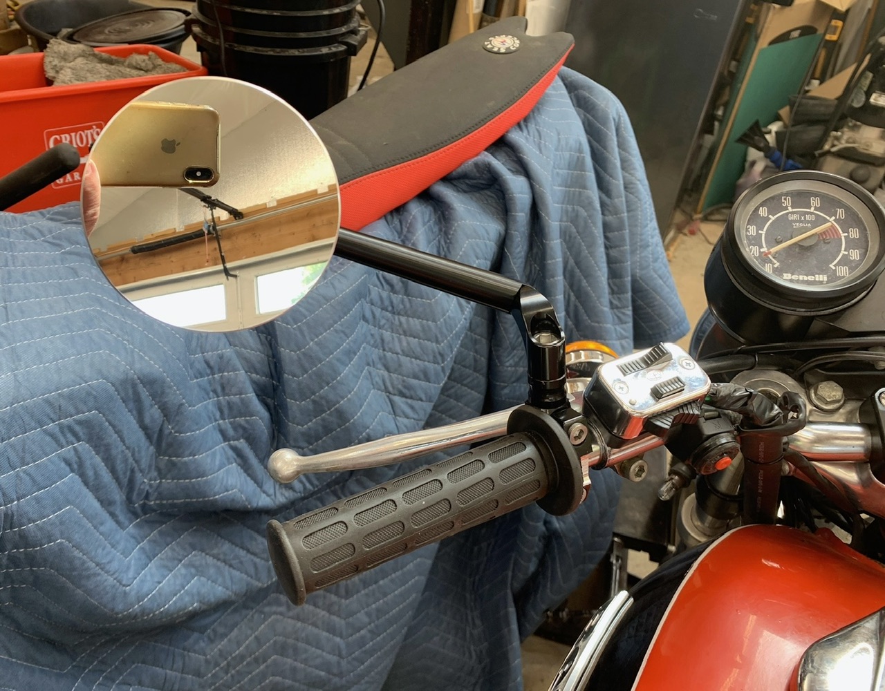

I had a rough mirror I had gotten from a previous bike and wanted to replace that with something more appropriate and that works well.
I happened to see the interesting mirror that had no glass and thought it was way too much $$. But then looking around at other decent mirrors, it was not much more.
So I bought one.
This mirror is made completely from metal, then a high polish and a coating to keep it shiny. It looked like the sort of mirror available in the 70s and I thought it would work, although I was not certain how I would mount it. It come with three screws with two different pitches and one left hand. Those fit lots of the ‘standard’ receptacles but of course I didn’t have one of those. I was going to make something, the issue being the kill button I fit. I found the mount for the old mirror would work and tried it further in- but I didn’t like the view. So I put it next to the grip, having to move the kill button.
The view out the back is great, the mirror looks as good as any glass one I’ve seen and appears to be very solid. I still would like to incorporate the kill button in the mount, but have not figured out how to do that yet.
Lots of time for a little thing, but I like having a mirror I can actually use well.

Postby John H » Tue Jun 13, 2023 8:10 pm
Nice combination. Is the mirror polished stainless steel? That would be clever. I've seen ss mirrors in public restrooms but never for bikes.

Postby Lotus54 » Wed Jun 14, 2023 9:39 am
I understand it is aluminum, with some permanent coating to keep from corrosion.
Motogadget m.View Classic Metalmirror
Using ultra-precision CNC machines with diamond tooling, Motogadget delivers the clarity of glass within the minimalist package of machined aluminum. The brilliant surface finish of this convex mirror is sealed using a complex plasma coating process. This patented surface is complimented by additional precision-machined components, all anodized to the highest standards.
Features:
All aluminum mirror body
Convex diamond-polished aluminum mirror surface
Plasma-coated mirror surface
Precision ball joint
Stainless steel hardware
Robust anodizing
Sold each
