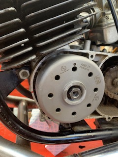

I’m working on another one of these for a buddy. I was going to start it before changing the Vape ignition/charging. But left cylinder has no spark. Then I found the flywheel nut loose and flywheel loose. So I think it was parked due to now spark on that side. I suspect the condenser (points tested ok).
So I will change install the Vape and go from there.

Postby Lotus54 » Thu May 09, 2024 6:44 am
New flywheel/stator mounted and timed
Re: Benelli 250 2C
Postby John H » Thu May 09, 2024 9:07 pm
Interesting that some other bikes attached these rotors without a key. The Z1R is the same and it causes real problems as the starter clutch bolts to the rotor.
