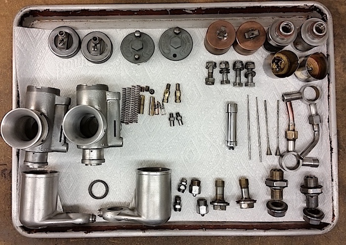

Postby John H » Thu Feb 07, 2019 8:39 pm
Here's some old racing carbs I'm restoring for my next project. They were originally set up for alcohol but will be set up
for gas. So new slides, needles and jets are on the way.
Amal TTs.jpg (218.87 KiB) Viewed 24289 times
