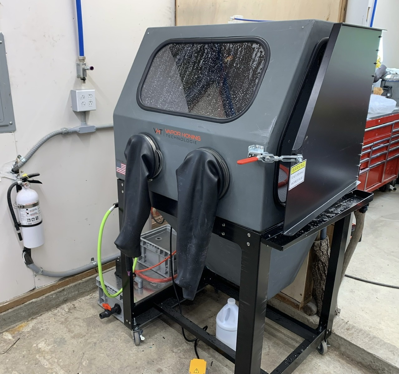

I got my new Vaporhoner setup. Still a couple little things I want to do- but tried it out and worked really well.
It will easily fit a 21” wheel, I did an 18” Borrani rim and it came out really nicely. Plus the Dynamo engine side cover.
I added more lights. It has one (fairly decent) AC one. But I added three more long LED waterproof strips. They run off 12Vdc and I have a power supply that I turn on with the same switch as the stock light.
The tanks on the left are for the ‘closed loop’ water. The water used to rinse parts (there is a spray nozzle inside to wash off parts after finishing- or to see if done) and the one for rinsing the window. Overflow water goes into those tanks and they keep most of any sediment out with those two.
