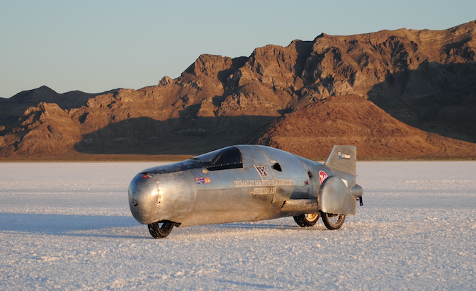

The Swedish Eagle is a future project. For now the plan is just to de-salt it then find a spot to display it.

:lol: 20' long, should fit right in there. Drips a bit of Castrol oil occasionally.
Re: WINTER PROJECTS
Postby Lotus54 » Wed Sep 28, 2022 8:56 am
That is a wild looking machine. What sort of powerplant?

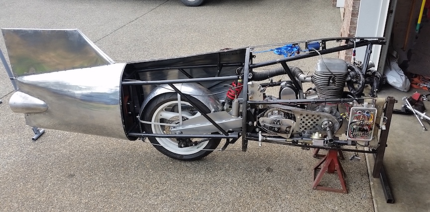

The streamliner was build around the Jawa speedway engine. The transmission is from a KZ1000.
Liner rear.jpg (222.95 KiB) Viewed 73024 times

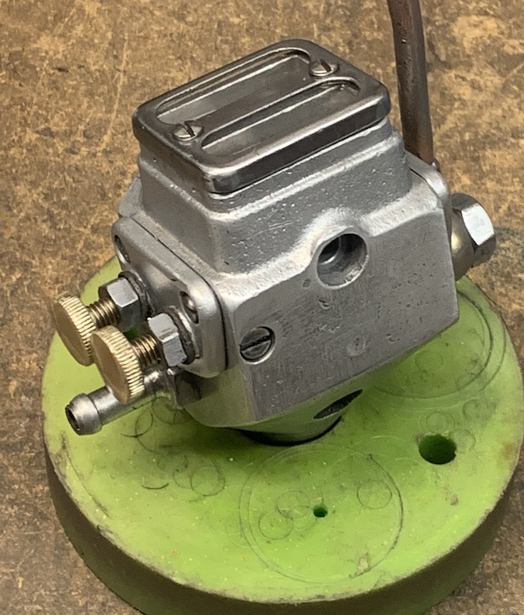

Before storage, the engine and gearbox need pickled. This means completely flush all fuels and oils with plain gas and thin oil. Nitro fuel is very acidic and castor oil will turn into glue.
Here's one of the oil pumps. Oil is metered separately to the top end and lower end with the adjusters. The windows in the top let you see how much is being pumped.
jawa pump3.JPG (214.81 KiB) Viewed 72982 times
jawa pump2.JPG (198.63 KiB) Viewed 72982 times

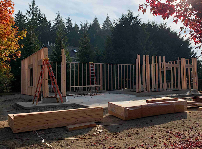

. This is the first winter project, a two car garage and adjacent motorcycle shop with an upstairs office loft in attic trusses.

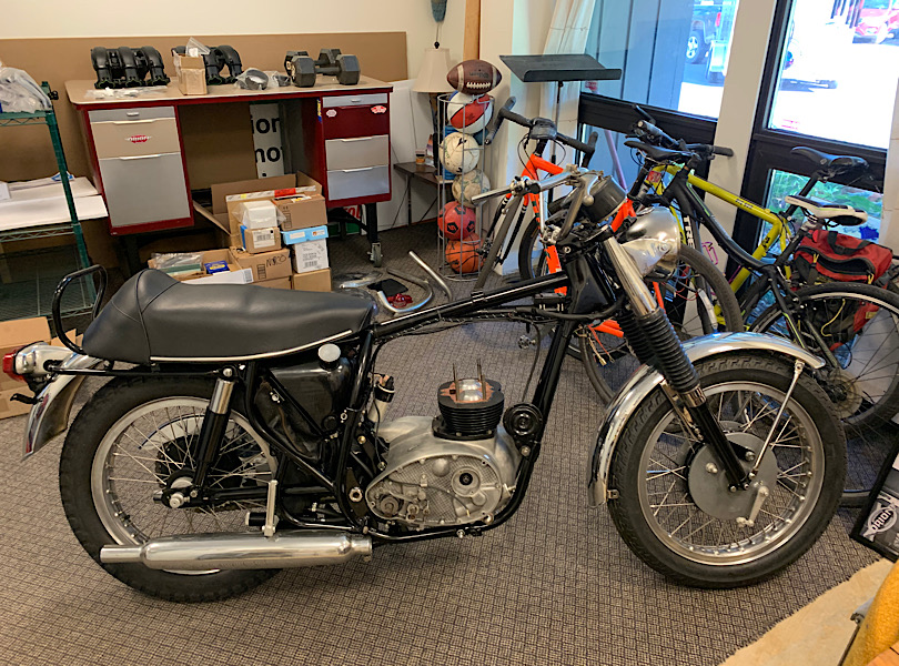

This is the second project, to be completed in the former; 1966 BSA Spitfire. Followed by the resurrection of a 1970 Royal Enfield Interceptor 750, and a rebuild of a Burman gearbox from the Vincent.

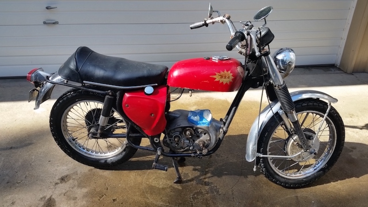

Your other projects are interesting too. We will have to share info when you get into the Spitfire, as I have a 67 Hornet project in about the same condition.
Missed you at the WVM meet last weekend.
My HornetR.jpg (314.98 KiB) Viewed 72905 times
