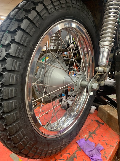

A 75 Aermacchi (Harley) 175 SX came my way. I have been getting it back to usable condition.
The rear rim was really bad, so I (foolishly) replaced with a new Borrani alloy with Stainless spokes/nipples. Front was usable. New tyres, tubes etc. I have some replacement forks that I will replace seals (original tubes were pretty rusty).

Postby Lotus54 » Sun Nov 03, 2024 10:23 am
Here is a photo (Latest update changed how to resize)

Postby John H » Sun Nov 03, 2024 9:42 pm
The front wheel must match the rear. Oh no, here we go...again. Ha. We're addicted. I'm tempted to put the quick change alloy wheel you vapor honed for me on the TR6. But that would mean I would have to do one for the front. Not going to happen..

Postby Lotus54 » Mon Nov 04, 2024 9:10 am
John H wrote:The front wheel must match the rear. Oh no, here we go...again. Ha. We're addicted. I'm tempted to put the quick change alloy wheel you vapor honed for me on the TR6. But that would mean I would have to do one for the front. Not going to happen..
Yes- I agree! It is a problem. But is certainly is fun to make them as good as possible.
I could have saved a fair amount using a Sun rim- or just a steel one. But heck- as long as doing it, may as well overdo it.
