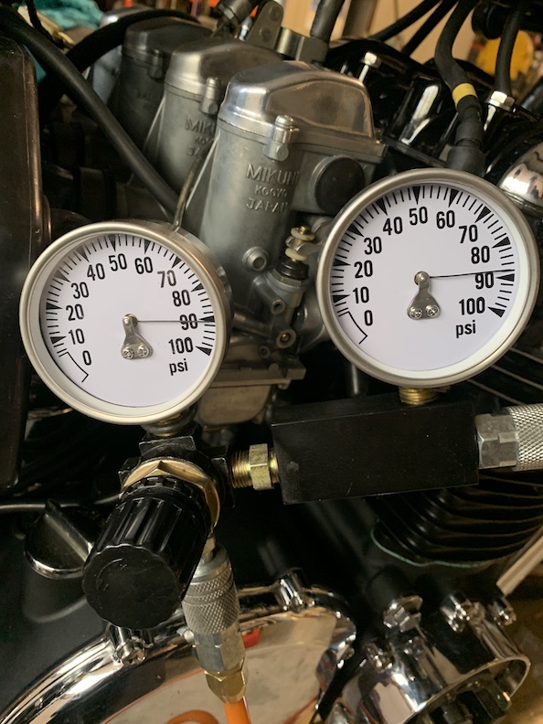

Well it runs, but not that smooth. It won't idle and does the crackle and pop in both the intake and the exhaust. Set the air screws at 1-1/4 but no help. A leak down check was in range with intake and exhaust silent so the crankcase vent sound was clear. Compression was 90#, not unexpected. A short trip down the road and back and compression was 120# on all cylinders and should get better once tuning is finished and a few miles are clocked.
