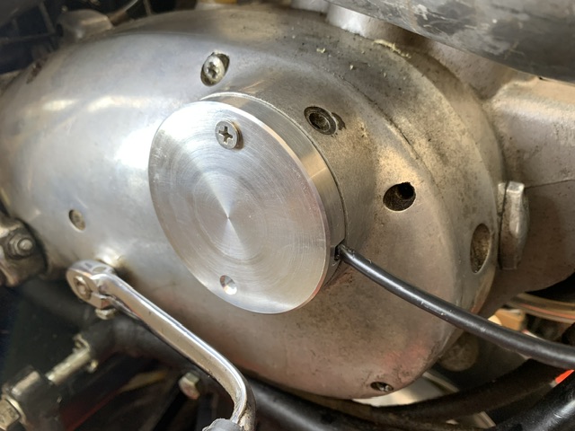

Postby Lotus54 » Wed May 14, 2025 6:56 am
After I made a 3D print of a cover that I liked- I did not have any hi-temp filament in silver, and could not find any easily. So I used the print as a model and made one on the lathe and mill.
Posts: 650
Location: Port Angeles
Re: BSA B50 ‘Gold Star’ 500SS
Postby Lotus54 » Wed May 14, 2025 7:37 pm
Here is a picture- only one screw and no gaskets/plugs etc.
Doing wiring now.
